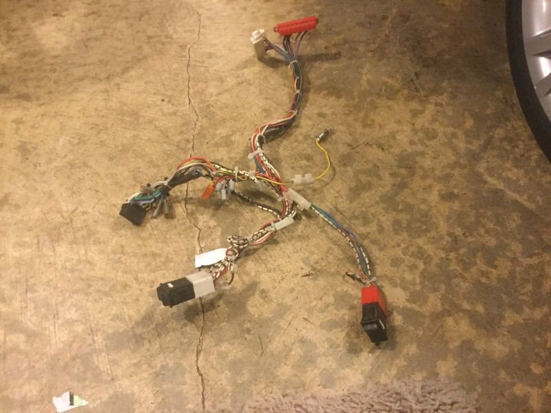

Here is a picture of the harness I pulled from my 79. The brown wire is the only one coming from the red connector in the radio harness. Let me know if you need more pictures or if you want the entire harness...it also has the power window switches.

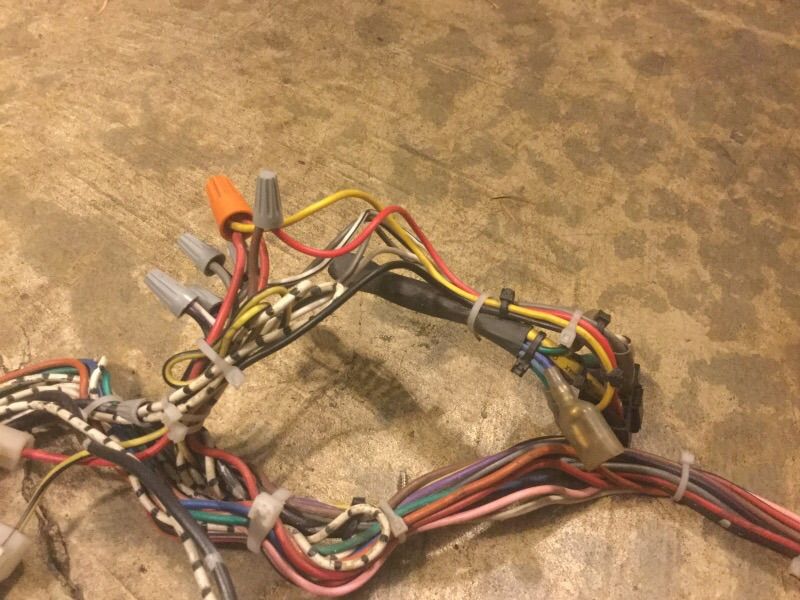

Here is a picture of the whole harness, hope it helps!
