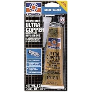

The red-ish sealant is probably RTV Ultra Copper.
For intake manifold and around carb gaskets you could use Permatex Hylomar Universal Blue.

Hi Kent,Kent124 wrote:The red-ish sealant is probably RTV Ultra Copper.
...I provided a tube of that when I had my manifold replaced. They mentioned they didn't use it, they also didn't give it back.
Can I assume that's the universal high temp application RTV of choice?
Thanks,
Mark

I use the red RTV for exhaust work and providing a seal on bolts going into the oil galley. I would NOT use it for intake work.
John Logan (Midwest124) recommends Permatex Hylomar Universal Blue (85249) for intake work. It is a very different product than the red RTV. Universal Blue seals well but never fully hardens making removal easy later on down the road.

Thanks Kent!Kent124 wrote:Mark, here's a link for the Universal Blue. Places like Auto Zone or Advance Auto Parts etc probably carry it.
http://r1.cygnuspub.com/files/cygnus/im ... 101187.jpg
