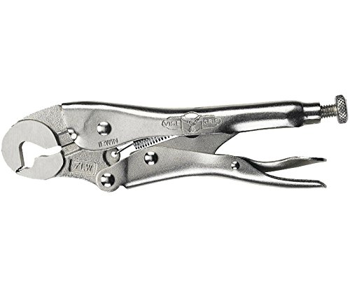

I've had good luck using the Vice Grips (Irwin) 4lw that employs the same principle as the OTC pliers. The 4" pliers work well even on rounded brake line flare nuts.

coopertl wrote:I've had good luck using the Vice Grips (Irwin) 4lw that employs the same principle as the OTC pliers. The 4" pliers work well even on rounded brake line flare nuts.
The Irwin Vice Grips have the added plus of a decent cable/rod/bolt cutter built into them. They quickly become a favorite go-to tool.
Here is the link. I have also been using these for years and love them.
https://www.amazon.com/Tools-VISE-GRIP- ... B00004SBBD

the new OTC pliers will prevent those "rounded off" brake line nuts. Traditional vise grips can crush the nut, causing it to be out of round. My set of the new pliers arrived and I'm quite impressed with them

The ViseGrip 4LW and 7LW are not the traditional locking plyers with the arced toothed jaws but are specially built locking wrenches for hex fittings with a one size fits all wedge style smooth jaw.
That is the tool I have been using. Fantastic gripping power. Still can take a lot of patience, penetrating oil and turning back and forth if the fitting is rusted to the line.
I have two of the smaller 4LW ViseGrip Wrenches and they are my goto tool now and always in the tool tray I take with me when I crawl under. When I find something stubborn or I do not have the exact size wrench in the tray they can save the day being useful for more than just brake lines and are extremely heavy duty. On a rounded off fitting, nut, bolt, etc that someone else has messed up they have saved me from having to find an immediate replacement and put me back on the road a number of times already.
